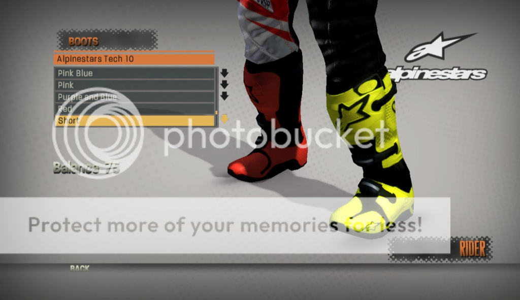

xenuh
Few things in a pack that will be released soon.  ;D
szalonym1
Xenuh boots looks nice ;D Make Dlc 11 . I make dlc 12: 22 new jersey. ;D For shift change normal maps for pants. Check out my shift :
If you want help for pants write me on steam.
