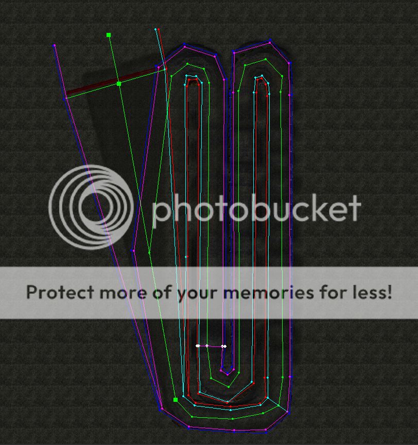

al167
I see the problem, you need to right click on the square on green line at the start line to select it. press the "merge sections either side of selected node"  button in the splines tab.
also add more nodes along the straightaway because if you crash it sometimes respawnes you to the next node, so someone may crash but respawn at the end of the straight and actually make time!!
heres a tip, use the right mouse to move nodes. as it wont create a new node and cause frustration.
heres how I done the Daytona spline
